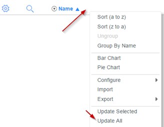

1. If you haven't already create a new update set.
2. Then Open the default update set
3. Right click on the default update set related list (customer updates) filter and select "open in a new window".   ***This step is very important, because if you attempt to update from the related list view you will update all records associated with the default update set and make cleanup even harder on yourself.
4. In the new list window you've just opened... devise a filter for all applicable update sets... likely, all updates updated by you within a certain timeframe.... make certain to double check and triple check that only the correct updates are selected.
5.   When you are certain only the updates you wish to transfer are viewable in the list right click in a column header and select "update All"
6. a form will open... set Update set to your newly created or correct update set.
***It is important that you do NOT modify created date or remote update set... or any other field unless you are 100% certain you know what you are doing at this time.     e.g. Only update "Update Set".
7. Click "Update"
8. Go into the correct update set and validate all desired changes are contained within it.
