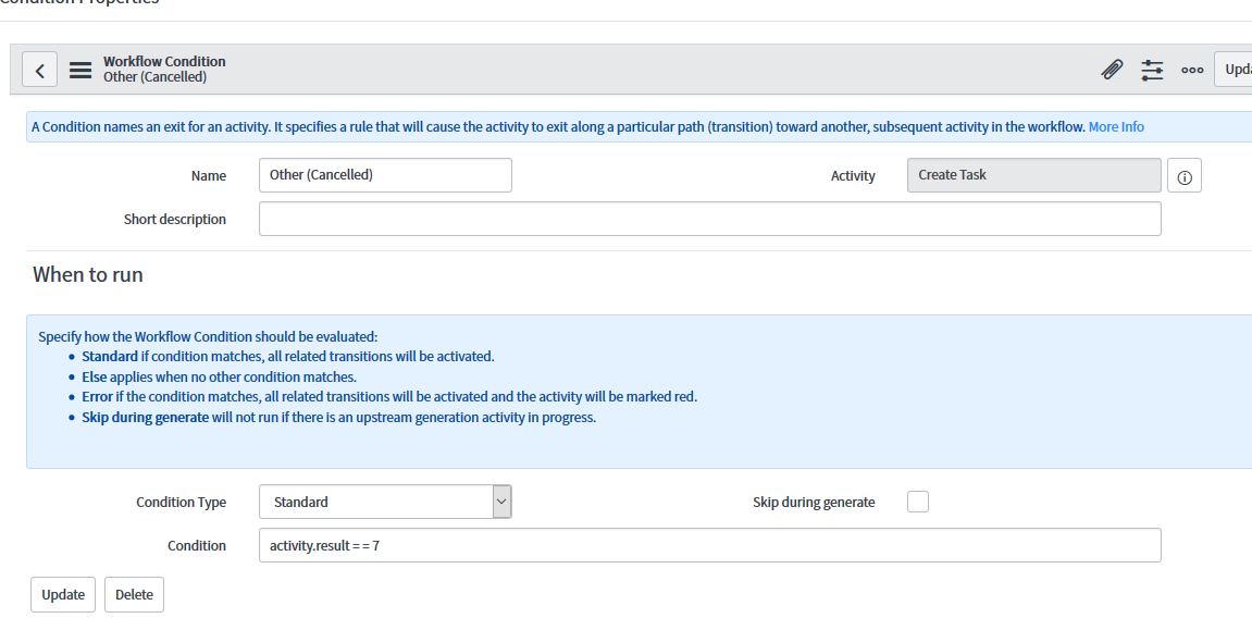

Right click on Catalog task activity then you will able to see Add condition
Here are the conditions that I'm using
where value 3 is the closed complete state value

Michael,
you can use closed complete and incomplete state values
and when the task is closed move ahead with rest of workflow
but if the task is closed incomplete then close the RITM and end workflow..
Here is the task activity with custom conditions
Thanks. Would this require any scripting in the Catalog Task? Also, how would I configure the Conditions of Complete and Other (Cancelled)? I tried doing something like this and it did not work so I know I was missing something.
