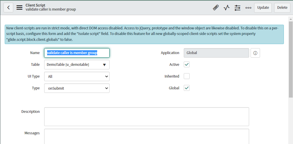

I am tasked with configuring an Ajax call on an on submit client script to check if a user is in a group, and if he isn't found in the group, post an error message. I've never worked with Ajax calls before and am unsure of how to proceed. Thank you.

create a client script :
