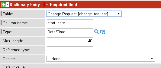

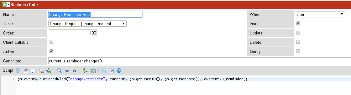

I get the error below. The Planned Start Date was actually Start_Date in the definition, which is why I have it stated this way below.
002.png@01CF75CD.E34FFF90
Exception (ReferenceError: "Condition" is not defined. (; line 26)) occured while evaluating'Condition - current.start_date.changes() && current.start_date != ''' in business rule 'Change Request Reminder' on change_request:CHG0035841; skipping business rule
Here is everything I have done, hopefully I followed your instruction. One Note is that I did not put any entry into the Reminder fields
1. Created field reminder in Change Table
001.png@01CF75CD.6F81D980
2. Created this business rule on change table
003.png@01CF75CD.E34FFF90
3. Created Event Registry
004.png@01CF75CD.E34FFF90
4. Created Business System rule
005.png@01CF75CD.E34FFF90
Hi Joan,
Can you please place a screenshot of the business rule which is throwing the error.
Meanwhile, try to replace the condition with following.
Let me know the results.

Can you see the screen shots below. I think I figured it out and it is stupid user error. In the Business Rule, I copied you information exactly and should have removed the Condition — and only put the current.start_date.changes() && current.start_date!="
