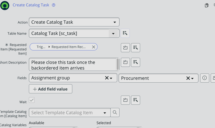

Hi @Nisha30 ,
Please Have a Look on "Service Catalog item request" Flow Designer , Use that as reference
    • Ensure you have selected Service Catalog as the trigger for your flow. If it's not appearing, check if the "Service Catalog" trigger is enabled in Flow Designer.
    • Go to Flow Designer → Triggers → Service Catalog and select "When a request is submitted".
  • Check RITM Submission:
    • Make sure the flow is triggered when a RITM is submitted. This can be verified by selecting the appropriate catalog item in the trigger condition.
  • Create Catalog Task Action:
    • In the Flow Designer, add an action to Create Catalog Task. Here’s how:
      • Go to Flow Designer and click Add an Action.
      • Search for and select the Create Catalog Task action.
      • Fill in the details, such as the Task name, Assignment Group, Description, and other fields as per your requirement.
      • Make sure to set the Parent field to the RITM (this links the task to the request).

I created this way as a fresh
Not sure whats wrong in executing real time
