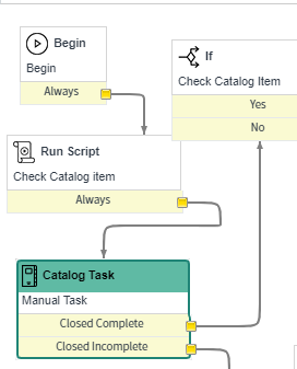

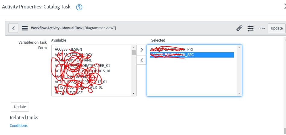

You can configure specified variable on workflow activity where you create task
Please see below snap for the reference
Open task activity where you can add the variables which you want to display on task form
