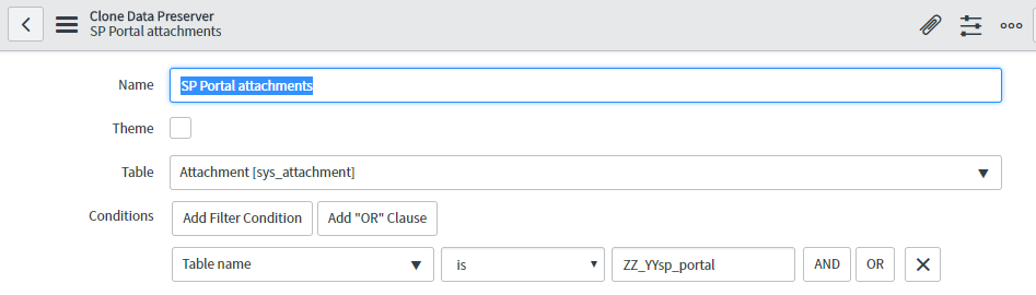

I think this method should work, but I don't have an environment I can test this on right now. This will preserve both the icon and logo files for the portal records:
Create 2 Clone Data Preserver records like this (pictured below, and attached to this reply as xml that you can import):
AND

No, that doesn't help.  The icon field isn't a reference to sys_attachment, it is an image.  The icon is stored, bit-for-bit, right there in the sp_portal.icon field.
-- lauri
just to clarify, did you try my suggestion and it didn't work? I reviewed the data architecture of those tables, and it appears to me that the records are stored wholly in the sys_attachment table. and I performed a test to confirm it (this is in Kingston, and I doubt the data architecture has changed since they rolled out image fields, but I could be wrong).
The test is to find the sys_attachment record related to your sp_portal record in the sys_attachment table that is named "icon". export that to xml and change the table_sys_id value in the xml to the sys_id of a different portal (one that doesn't currently have an icon). then re-import that xml. By doing just that, it moved the icon from one portal to the other, which suggests that the icon is fully stored in the sys_attachment table, not in the sp_portal record itself.
I would be interested to see if the suggestion works, but I don't have multi environments I can test this on right now.
