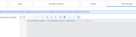

12-05-2023 07:16 PM
Hi @Bird1
In your custom workflow activity, you can include a step named "Post Processing." Within this step, you can add an Output process script where you use the replaceAll function to remove the character "\n."
Cheers,
Tai Vu
12-05-2023 08:27 PM
Could you please advise?
This is my output variable.
I've tried to add the post processing script like this
When I tried to run testing, it still shows \n prefix.
