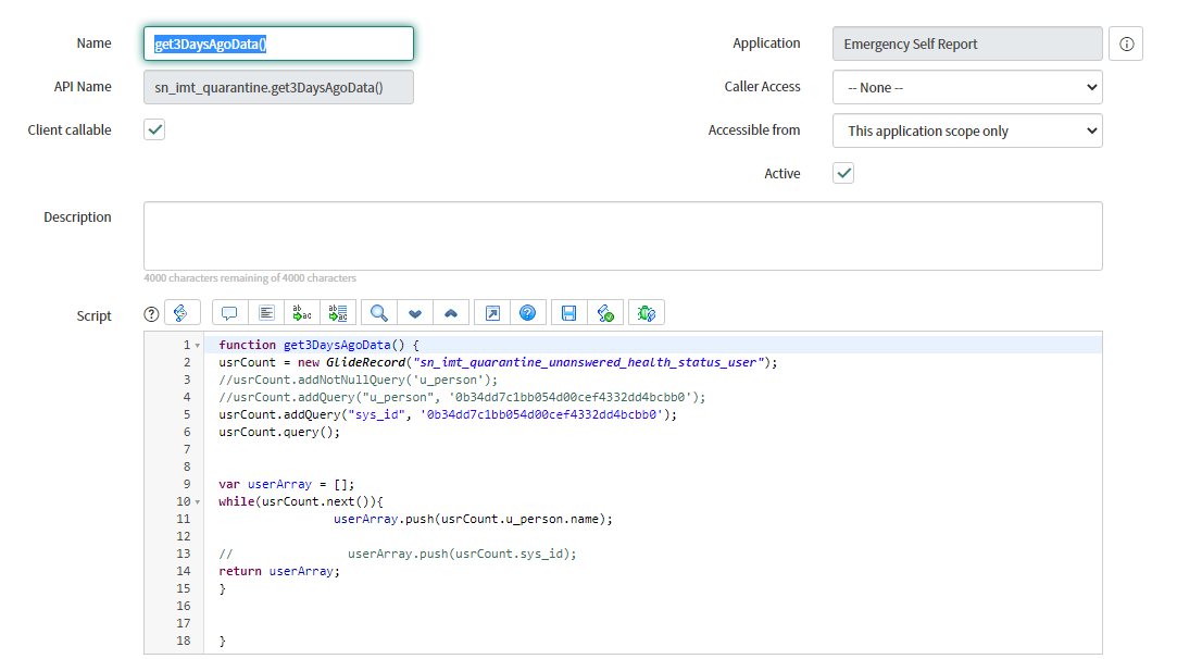

Hi Gurus,
Is it possible to retrieve data that has an updated date equal to Yesterday AND two days ago AND three days ago.
I see there are built-in options for today, yesterday, last 7 days etc, but that goes back to far.  I just need for the past three days.
Let me know if you think this is possible.

usrCount = new GlideRecord("sn_imt_quarantine_unanswered_health_status_user");
usrCount.addEncodedQuery('u_unanswered_dateRELATIVELT@dayofweek@ago@3^u_unanswered_dateRELATIVEGT@dayofweek@ago@4');
usrCount.query();
var userArray = [];
while(usrCount.next()){
usrCount2 = new GlideRecord("sn_imt_quarantine_unanswered_health_status_user");
usrCount2.addEncodedQuery('u_unanswered_dateRELATIVELT@dayofweek@ago@2^u_unanswered_dateRELATIVEGT@dayofweek@ago@3^u_person=usrCount.u_person.name');
usrCount2.query();
while(usrCount2.next()){
gs.log('here1');
gs.log(usrCount2.u_person.name);
userArray.push(usrCount.sys_id.toString());

I got it..
userArray has the sys_Id and you are passing this sys_Id to a Person Name.
Instead you have to try passing the Name to Person Name which will return the records.
Try running your script in script - Background by printing userArray[0] value and make sure the result shows name instead of '0b34XXXXXXX'.

Even with script that returns the name value, it still returns NULL for the records from the table.
I still think it has to script include, maybe its not defined properly.

Your Script Include name should be get3DaysAgoData. Please remove brackets () at the end of script include name and try again.

I don't know why it doesn't pick up yesterdays transactions, could it have something to do with date formats are not compatable?
Hi Rjp,
I guess its something related to timezone difference.Because for me its showing the report as working fine.
And yes the date time format might be the issue and timezone difference.
The filter is correct as i tested in my PDI. There must be data issue in your instance.
Can you check for other days( 4 days, 3days and 2 days ) it must come.
