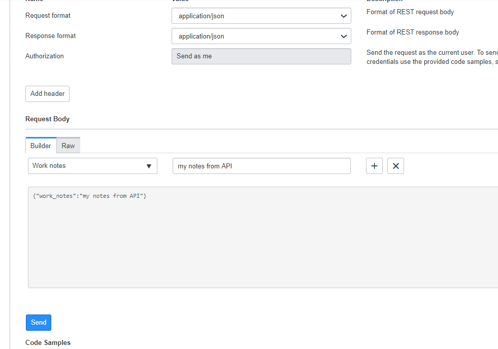

How to update work notes of a catalog task from table api (sc_task table)
you should be able to
if that doesn't work then try this
Use Raw and try this
{"work_notes":"my notes"}
Output:

Ankur Bawiskar
Steps below
Use HTTP -> PUT Method
Endpoint: https://instanceName.service-now.com/api/now/table/sc_task/{sys_id}
Hit Send button
Output:
Hi Ankur
Shockingly i am not able to find work notes in request body "add fields" drop down
Output:
  "error": {
    "detail": "Record doesn't exist or ACL restricts the record retrieval",
    "message": "No Record found"
  "status": "failure"
