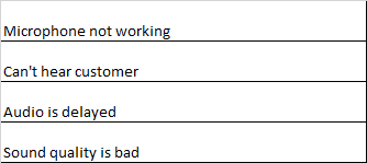

I have a catalog form where I have two select box variable called Category and Subcategory. Category and Subcategory has various choice. My requirement is when a choice is selected in Category only a specific set of choice should be available for Subcategory. Example below.
Category has three options
Subcategory has following options
But when Audio issue is selected under Category only following options should be available under subcategory
Other category and subcategory as below
Catalog Form
Any help is highly appreciated. Thanks in advance!
