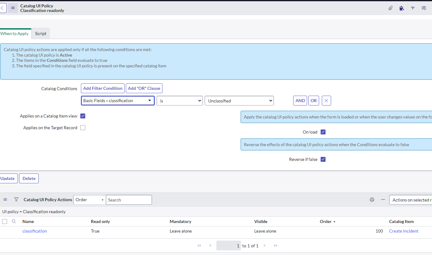

05-18-2022 01:46 PM
As Catalog UI Policy condition, select your classification = Unclassified. Prefer to create these rules into the specific items rather than into the Variable set itself.
Example: (variable set name Basic fields)
Mark correct if it was helpful 🙂
