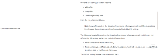

@anuj27 @AnujT  Sharing the support case details as it was not opening the link properly.
Determining why attachments were excluded from a clone
Description
Sometimes you will find that attachments are missing after a clone. Some of the symptoms are:
  • Some attachments are available in the target instance after the clone, but not all.
  • Attachments missing after a clone.
Cause
Attachments missing after performing a clone are typically the result of having the Exclude large attachment date selected
Resolution
To determine if this is selected in your instance:
  1. Type "Clone" into the navigation filter.
  2. Click Clone History.
  3. Sort Created Z to A and locate the last clone requested.
  4. Open the record.
  5. De-select Exclude large attachment data if it was selected and re-run the clone.
Link : https://support.servicenow.com/kb?id=kb_article_view&sysparm_article=KB0535353
