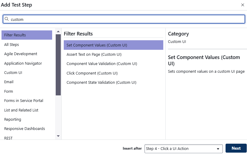

@saikumar2620 ,
You are trying to submit the Risk Assessment on the Change request.
The Questions showing on the Popup will have the SysId of the Change request as an Id of those Questions. Because of this, the Id of those Questions will change every time.
The workaround for ATF is:
Open the Assessment record created for that Change.
Click on 'Take Assessment' UI action.
Using 'Set Component Values (Custom UI)' set the values as needed.
Using 'Click Component (Custom UI)' click on 'Submit' button.
