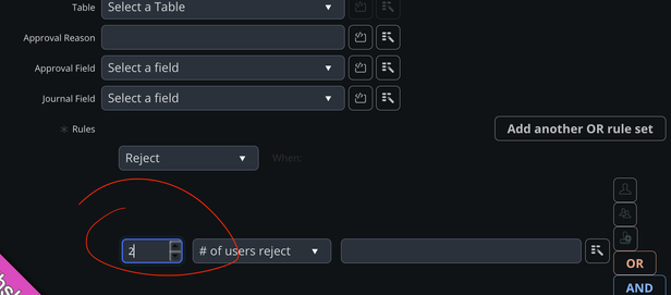

We are facing an issue with our approval flow configuration.
When we select two approvals required, the system generates two approval requests as expected. However, even after approving one approval request, the RITM still waits for the second approval before proceeding.
How can we configure the flow so that if any one of the approvals is rejected, the RITM can move forward without waiting for the second approval?

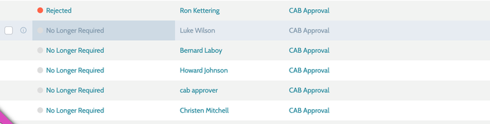

Dr Atul G- LNG
Hi @Pratiksha KC
I believe it's out-of-the-box (OOTB). If you look at the Change module, it’s fully OOTB. You can refer to that as an example and build your own accordingly.

Yes, it will wait because the flag logic takes precedence, and until both are rejected, it depends on what you mentioned here.
Did you check my response and OOTB configuration?
