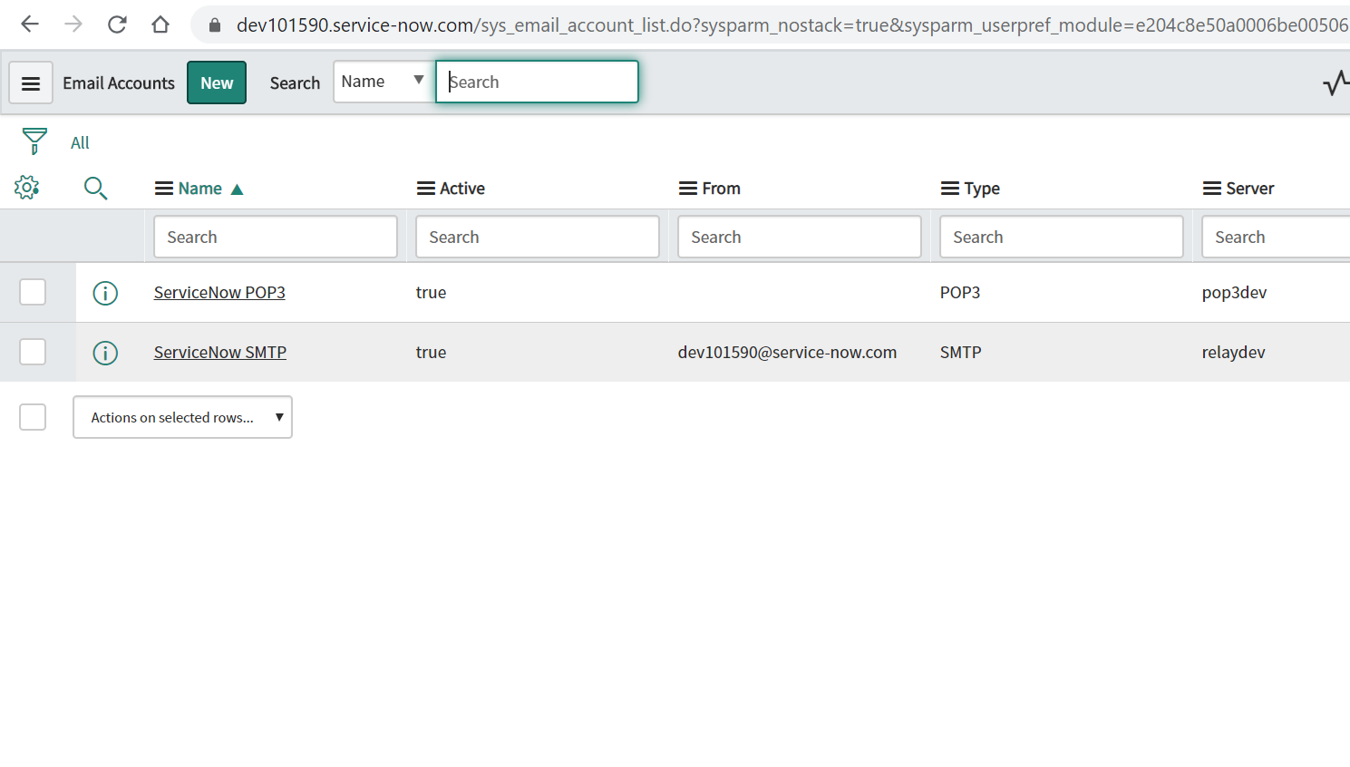

Alberto Consonn
you need to change the SMTP from email address to dev101590@servicenowdevelopers.com, below my PDI configuration:

Joaquin Campos
Hi Prerana,
I'd firstly test your SMTP connection:
If it works, I'd then check the inbox mailbox because emails should be there:
Regards:
Joaquín
