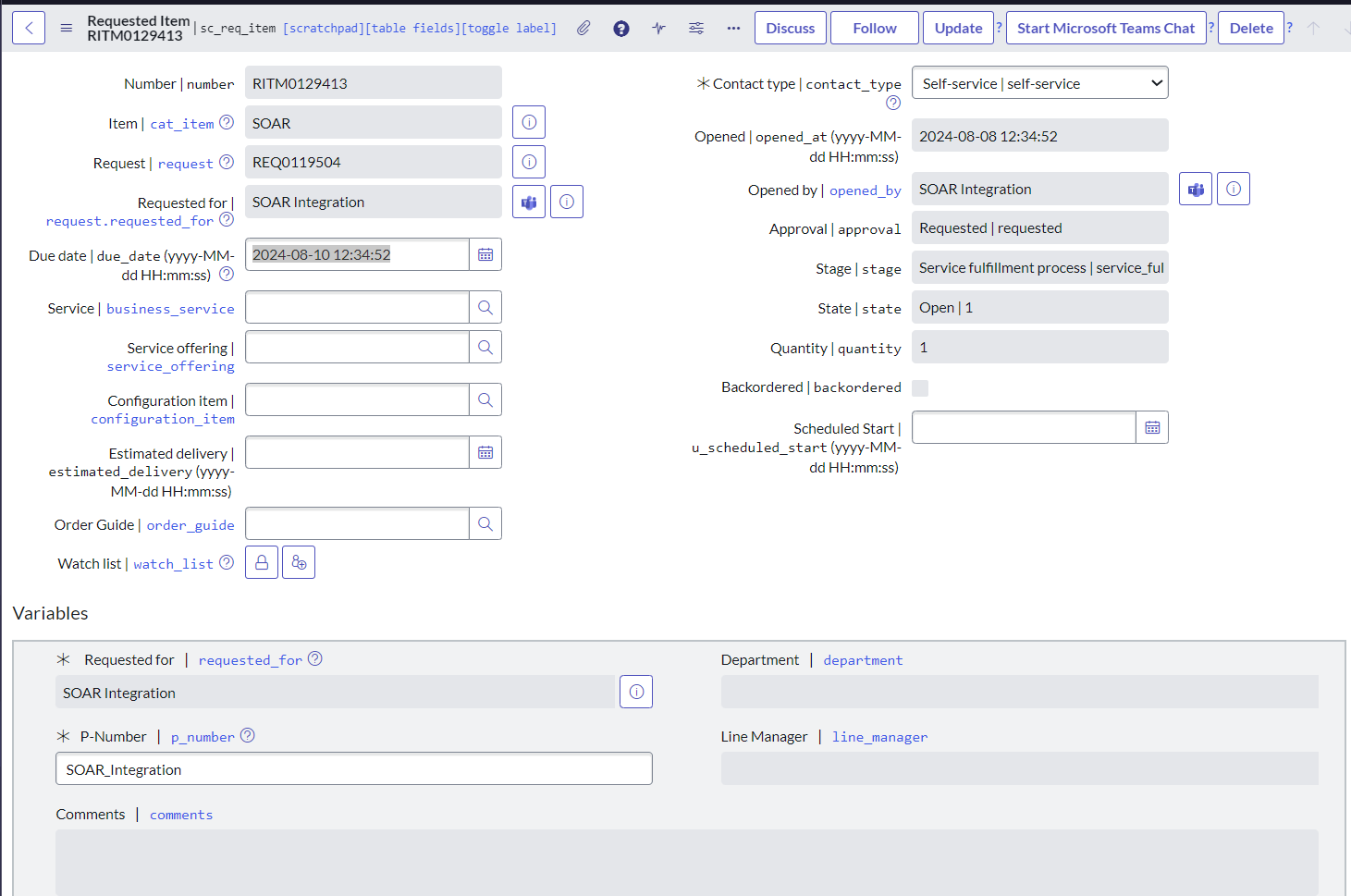

Please assist me in getting the following done, I am on Washington release of SNow:
We need to integrate with SOAR. They want to automatically create a service request in ServiceNow and in that request they want a text box in which they can copy all the necessary information in.
I created a service account. I am just not sure what extra roles are needed.
I created a catalog item for them (SOAR).
I created a REST API with two records (create request and retrieve request).

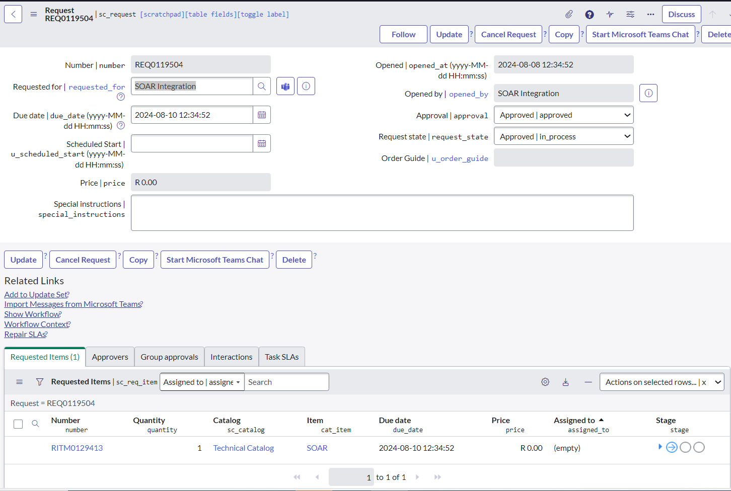

The request gets created successfully (REQ, RITM and SCTASK) but nothing is populated in the task. I want to use the description field as their string field so they can populate all the necessary information in there.
Or if there is a better way to do this, I would appreciate any assistance. I attach screenshots of everything I did.

I have been battling with this since you gave your answer. I am not a developer, I don't understand the coding and I have never done REST API's before. I am a fairly new administrator but we don't have a developer so I am expected to do everything. I cannot tell you how much videos I have watched, how much articles I've read, how many times I've tried and retried and retried. I cannot get it to work. One of the things I cannot do is:
  • Use a Catalog Task Workflow or Script to map the variable to the description field in the resulting tasks (RITM, SCTASK).
I am doing courses in the mean time to skill myself up but this is a request that needs to be done as a matter of urgency so there is no time to wait for me to be upskilled. Can you please explain how to do the bulleted part in my response? I did create a business rule but not sure if what I did is correct. I attach a screenshot so you can see at least I tried.

Rajesh, thank you for all your efforts. I am trying it out now. Just a quick recap of what the end goal is:
SOAR and ServiceNow needs to be integrated so that SOAR can automatically create a request in ServiceNow through a catalog item (soar_integration). They also need to be able to populate the 'additional_information' field with information which then needs to be stored again. I am not sure if it is in the RITM or the SCTASK. I was under the impression that it needs to be stored in the task as task gets automatically sent to the 'BST-Database Admin' group. The problem is I don't get the request number back and SOAR needs that to setup on their side.
So we should do a POST to place a new "order" and also provide the additional_information in the request body, then get a REQ number back.
