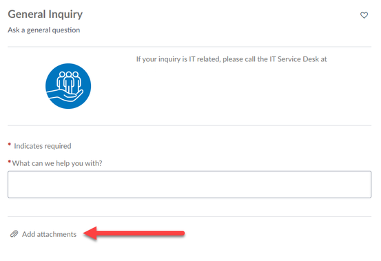

Is there a way to remove the "Add Attachments" icon from one service (but not all of them)?
Rylie Markle
We are looking for a way to take the paperclip icon off of one HR Service. Is there a way to do this?

Hi @Rylie Markle ,
1. Navigate to the catalog item in which the "Add attachments" paperclip needs to be hidden
2. Create a new variable of type 'macro' to the specific catalog item
3. Navigate to Service Portal Configuration
4. Create a new Service Portal widget with the following codes in Client controller:
function() {
/* widget controller */
var c = this;
angular.element('label.ng-scope').hide();
//NOTE : The above line here is a JQuery selector inside the angular.element() which is supported in service portal, feel free to change this JQuery selector if you want the attachment element selection to be more specific. In the above code the element label and the class combination are used to hide the attachment
5. Add the widget to the Macro type variable created in step 2

Hey @Rylie Markle,
There is no need to write scripts here...
In your catalog item, select the 'Hide Attachment' checkbox and that's all there to it.
Add attachment option has been disabled, thanks for the solution.
