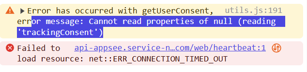

I also checked the developer console, and I’m seeing the following two error messages (see attached/screenshot).
Do you have any idea what could be causing them?
Or do you think it would be better to open a case with ServiceNow Support at this point?

‎07-23-2025 09:19 AM
Looks like some property issue.
Better to log a case with ServiceNow.
