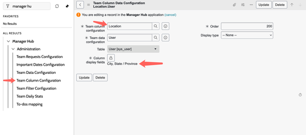

Hi @JDX7913 ,
The location column for that widget is made up data from multiple fields because it's a list collector. I believe it alphabetizes starting with the last item first and then moves to the next (right-to-left).
So in the screenshot you provided it is sorted by what looks like state abbreviations. CA, OR, WA (except for David Loo as that looks like a date and starts with a number thus numbers come before letters when sorting).
Probably modify the "Team Column Configuration" module under the "Manager Hub configuration" application
