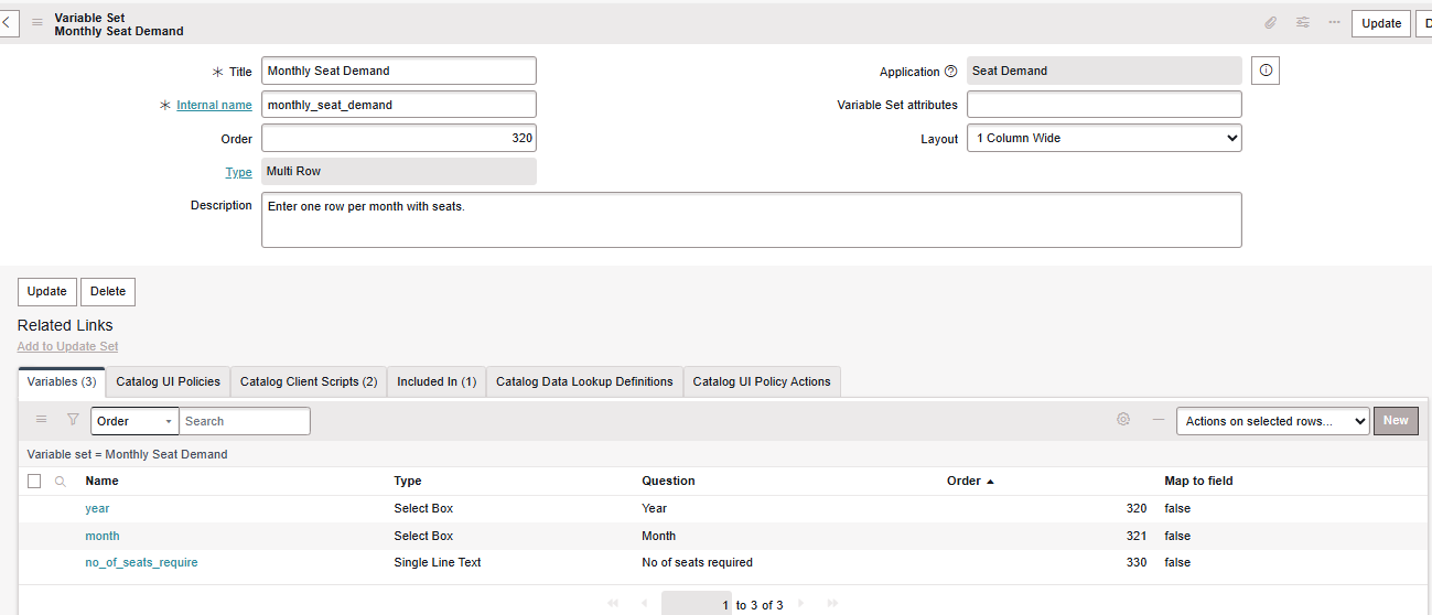

I Want to populate my mrvs data from record producer to a table under a related list of a custom table form view.
I have created a custom table for the other fields to store the record producer data once submitted. And I have created child table with year, month, no_of_seats_require as same as MRVS fields, and parent field which is reference to custom table.
In the producer side I have used this code to initialize the record on the table mentioned:

record producer is on which target table? Parent table?
If yes then why to write current.insert() when record will already be created when you submit record producer?
what debugging did you do in your script?
1) table name and parent field is correct?
2) fields you are trying to set are correct? is the field type matching against variable type?
3) variable names from MRVS are correct?
4) add gs.info() and see
If you are trying to set reference field from choice variable then it won't work

@JyothiD
unless you add logs you won't know what came and how are you mapping.
try this
