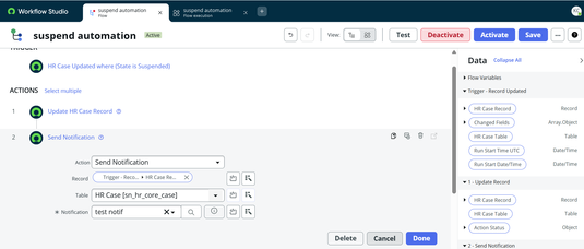

Hi Everyone,
I created a notification on the parent sn_hr_core_case table whose send when is set to 'triggered' , i have created a flow designer as well on the sn_hr_core_case table and in advance options set to run the flow on current and extended table.
But when i'm following the start conditions for any child table e.g. payroll case , it is not triggering the notification, but when i test the flow designer via 'test' button available on flow designer, i can see at that time the notification triggering (checked in the email logs i.e. sys_email.list)
does anyone know how i can make that happen? as i do not wish to create multiple flow designers and multiple notifications on each table.

@kartikey
When you use Test you are testing it via Parent table (HR Case) and hence it's working.
Notifications on parent won't run on child, it's a OOTB platform limitation/feature.
you need to have separate notifications for your child table.
then i need to create flow designer for all the child tables as well?
@kartikey
yes either have flow designer on child
OR
have separate notification on each child table and let it trigger based on condition it satisfies
