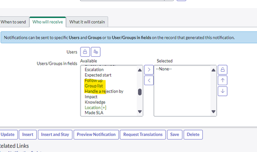

Hi @dev_K ,
Follow as below:
Click on the group, + icon will appear
Now, click on that + and from left search group email, move it to right:
Mark this as Helpful / Accept the Solution if this helps
07-01-2024 12:52 AM
This is what i am doing but i do not see 'group email' when i expand the options...
07-01-2024 12:59 AM
I just noticed, you are on sysapproval_approver table.
You have to dot walk as below:
07-01-2024 01:03 AM
OK, I did it that way and I have tested it by submitting a catalog request with approval and I see in the log that emails were sent to each member of the group... any ideas why?
07-01-2024 01:07 AM
If the Include member checkbox is ticket, the email is sent to all group members:(also mentioned by Atul)
Uncheck it and try.
