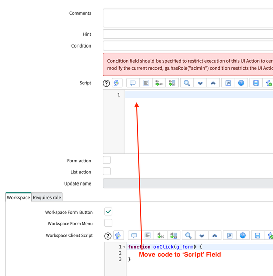

Looks like you have called the script inside "function onClick(g_form) {", which will only work for client side but you are calling server side function inside client side block hence its not working.

This wont work. You cannot mix Server and Client Side API like this. The Code you currently have using the server side API ("current" and "gs" are can only be used in server side scripts).
You need to move the Script from the "Workspace Client Script" field to the "Script" field:

Hi @hvrdhn88 - So I have a button in workspace that I am trying to have open the document.  So if I am doing it this way, then I believe the script is in the right place.  However, it sounds like I need a client side script that works with the UI Action from what you mentioned above.  I am just not sure how to achieve this with tying everything together from the UI Action to the Client Script.  Once I get it done the first time, I will have it, but I am not clear enough on how to accomplish it.  I provided a screen shot of the workspace showing the UI Action button that a user will click in order to open the document.
