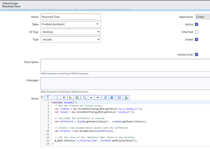

I've created a new field (Duration) called Resolved Time (u_resolved_time).
I've added the 'Close Problem' button on the Problem form.
I've created a new Client Script on the Problem table (screenshot below).
If I open a Problem that is not closed and is showing the state as 'Work in Progress' and close by clicking on the 'Close Problem' button, the 'Closed' field gets a date/time, but the state of the Problem changes to 'Open' and I don't see any value in the 'Resolved Time' field.
I've configured the Client Script Type for onLoad.
