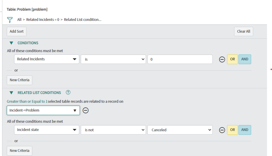

Hi Rohila,
It seems to be ones that match the following criteria:
So the count is not getting calculated?Check the history.
Can you test it out in non-prod instance for one of the above filtered problem and check if count is re-calculated or not.
Also verify 'Update Problem Incident Count' BR conditions and code.
