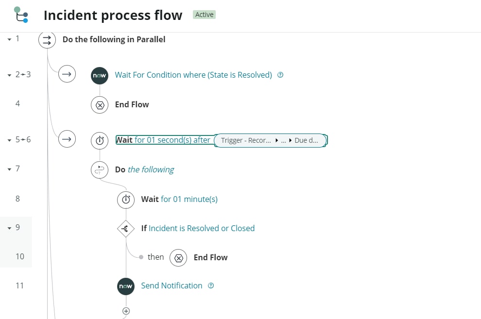

Hello Souvick,
If you have created a flow designer to update the HR task as per the process then to trigger a reminder mail in flow designer at interval of 3 days untill the task is closed or cancelled, then you have to run 2 Do the following in Parallel flow logic.
1st flow under Do the following in Parallel will do the updates on your HR task as per your process. In my case it is waiting for conidtion where Incident's State is Resolved and if this condition is met the flow will end
In 2nd flow under Do the following in Parallel, you can specify the logic to send the reminder notification as shown in below:
You can use Do the following flow logic and in until condition specify your condition like HR task state is not Closed and State is not Cancelled
In my case the notification is getting set at interval of 1 minute (you can set 72 hours) until the incident state is not Resolved and state is not closed condition is true.

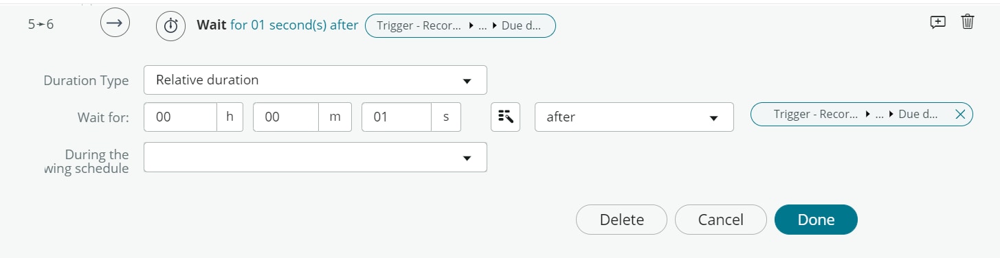

Hello Souvick,
You can add Wait for duration flow logic as shown below at the start of 2nd parallel activities and your flow will proces 1 second after the due date on your record.
Updated flow look like this:
Please mark my response as helpful/correct, if it answer your question.
