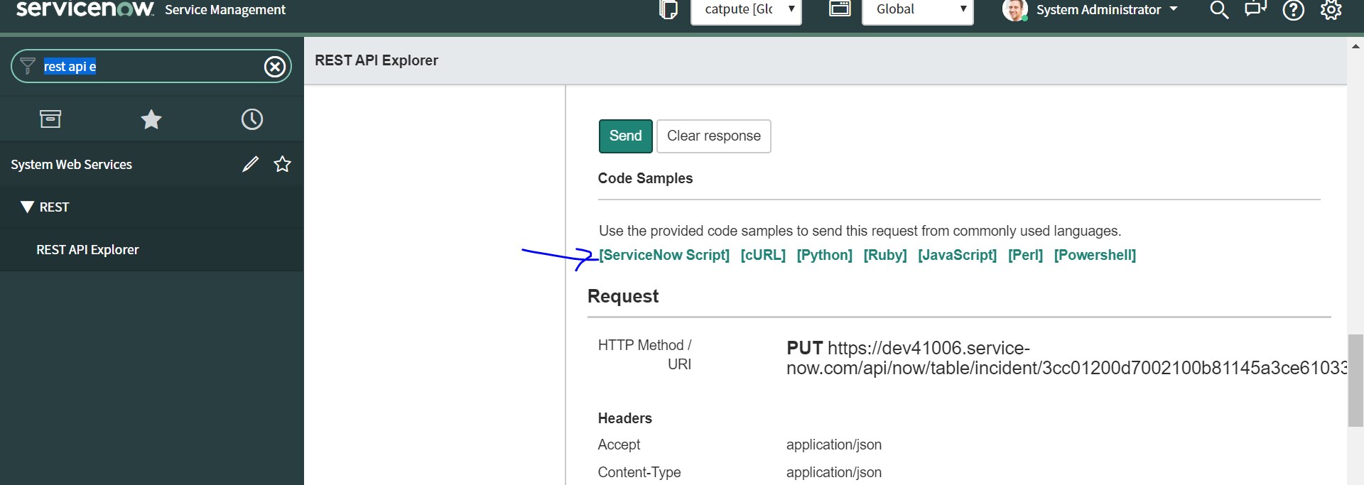

As far as your issue is mentioned, you should use REST API explorer to generate sample payload and use code generated by platform like below
