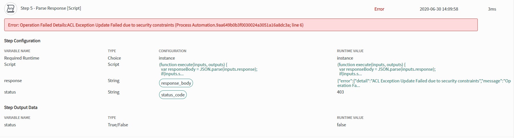

A. The Trigger and Action that I have defined
B. Below are the errors:
Suhan Dasgupta.
A 403 indicates you may not have permission to update something on the remote system. Have you checked the credentials to ensure they work properly?
Hi Chuck,
Yes, I have verified the credentials as well as the ACL rules on the field that I am trying to update.
Suhan Dasgupta.
