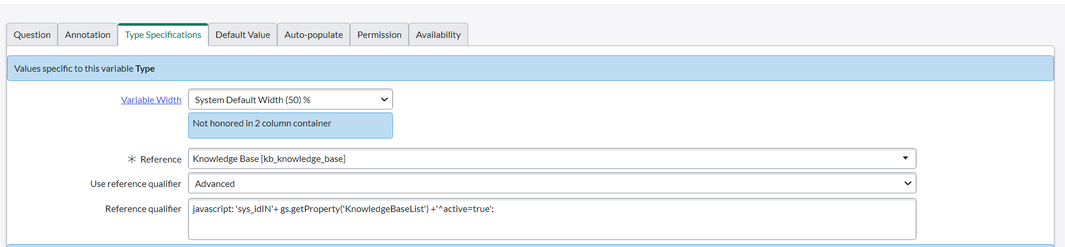

@chatsaurav19 For this requirement, you can simply add below one line of code in "Reference qualifier." Script include is not required here. I tested this and its working fine. I have added "Active = true", just to show only active KB bases.
javascript: 'sys_idIN'+ gs.getProperty('KnowledgeBaseList') +'^active=true';
Replace your system property name here in place of "KnowledgeBaseList".

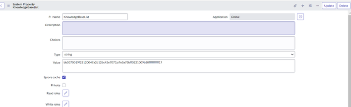

Also in your system property, list of sys_id's should be mentioned as comma separated like below

09-12-2023 07:28 AM
Hi @SANDEEP28
Thanks a lot! it worked! Can you also please let me know how to show this is as a drop down choice list? It is actually showing up as a lookup icon.
Thanks for the help! Actually it is a reference field.
