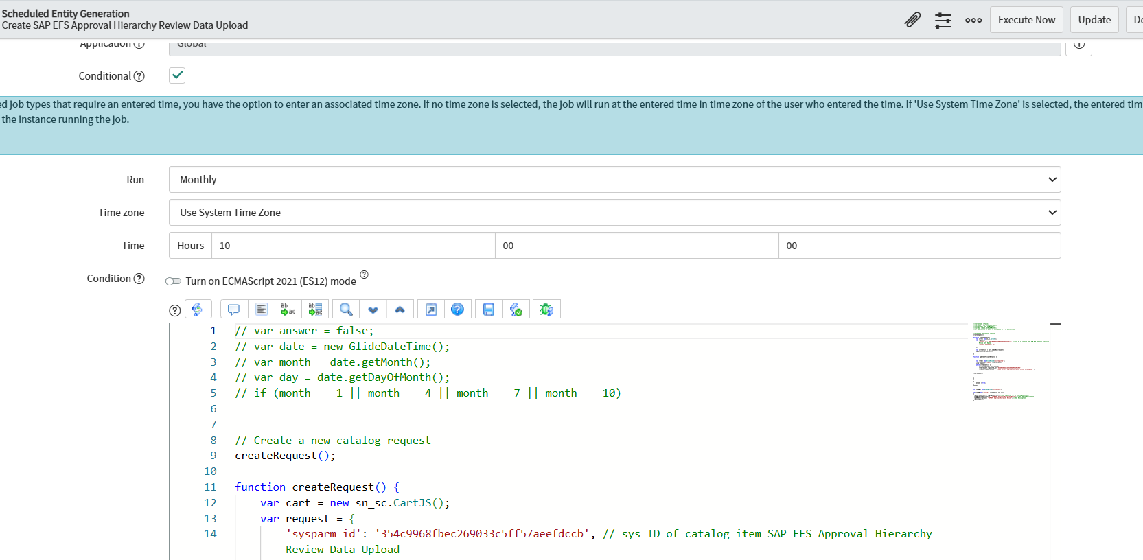

I have created a catalog item that I want to automate the trigger of that catalog item every 3 months. I used scheduled entity generation to automate this and wrote a script to create an REQ and RITM for the same. But the values in REQ like requested for, short description and description are not populating when I execute it using the execute now button present at the bottom left corner. I have the same fields (requested for, short description and description) present on the catalog item as well. I tried to Glide Record as well but values on REQ number generated does not populate. Find the screenshot below for the code.

Ankur Bawiskar
@nupur_goswami
share the script here and not the screenshots.
@Ankur Bawiskar
Sharing the script here

@nupur_goswami
use this
orderNow function returns JSON object so updated the code to send the REQ sysId so that updateRITM function can query it correctly
