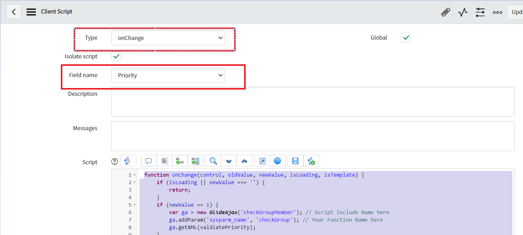

Please see screenshot below:
Sharing Script Include and Client Script again for reference:

Client Script:
return;
if (newValue == 1) {
var ga = new GlideAjax('checkGroupMember'); // Script Include Name here
ga.addParam('sysparm_name', 'checkGroup'); // Your Function Name here
ga.getXML(valdiatePriority);
function valdiatePriority(response) {
alert(typeof answer);
if (answer == 'false') {
g_form.addErrorMessage('Your Message Here');
g_form.setValue('priority', oldValue); // To revert to Old Value
Put alert in different line on client side and see what value is coming and let me know..
