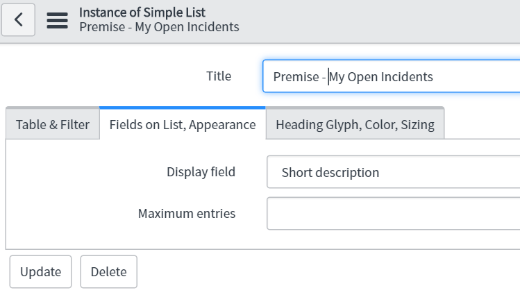

Thanks I did create a widget instance of Simple list which points to the Incident table. Where is "Link to this page"? When click the pencil icon on the widget instance I do not have that option.

That makes sense but I don't have that. To my knowledge we are on the initial Helsinki release, could this be an issue that was resolved in a patch? Any idea if this can be accomplished with code in the widget instance?
