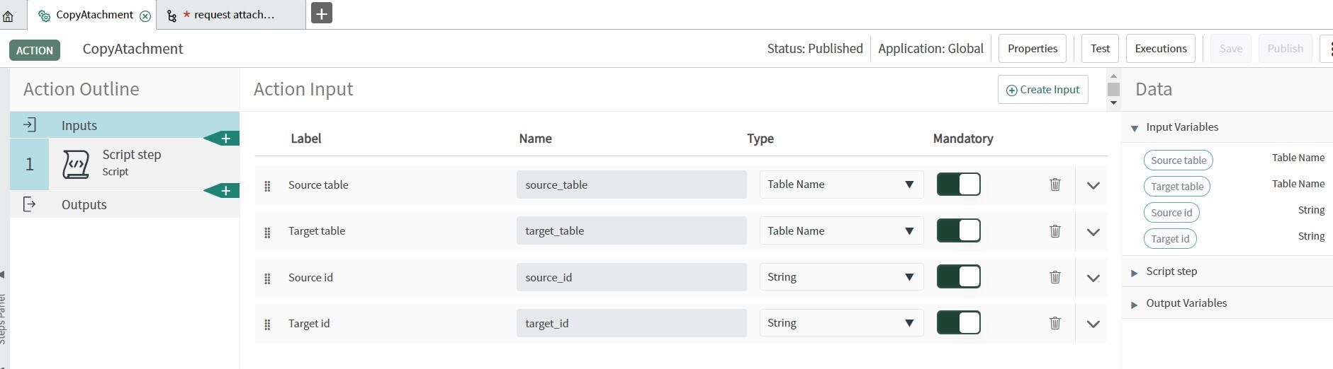

Better to create "Copy-attachment" action and use in main flow to copy the attachment from source to destination.
Create inputs variables,
used in Script step:

have created the new action as suggested.
Action Inputs:
Action Script:
