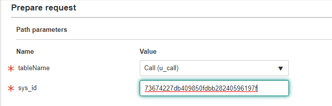

We are not able to update State field in Call table from rest user. I checked all the business rules and data policy no restrictions. Write access is there for State field for Rest user. But still not able to update State. I am testing using rest api explorer by impersonating as rest user.
I can update all other fields in call table but State is not updating. From the UI Rest user can update the State field.
And strange behavior is, i tested even as admin, but still i cannot update State field field through rest api.

Read only was set in the dictionary level of that field. I removed the read only from dictionary level and it is working. Call state field is updating from rest api.

Our's is a custom table. u_call is the table and u_call_state is the field.
If you are not working with new_call, please supply the table name. - I did not understand this statement.
can you please let me know where to supply the table name.
