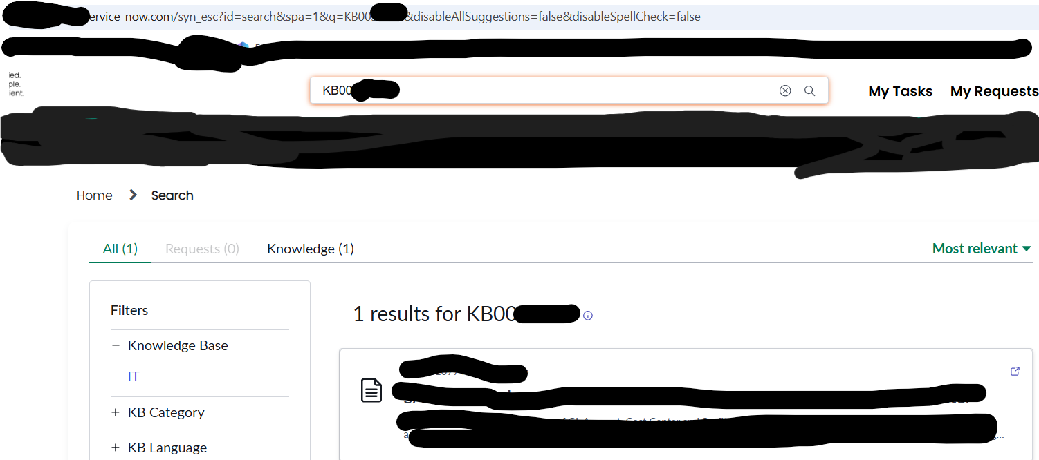

12-12-2024 06:12 AM
Hi Marshal,
Thanks for your reply we are already using AI search in EC still issue is there when article is searched with Kb number I have attached the screenshot as mentioned in 1st & 2nd screenshot when searched if we get that result then if click on the article it is loading fine.
But when searched with Kb number sometimes getting Exact match with id as mentioned in the 3rd, 4th and 5th screenshot at that time facing the issues url also redirecting to different.
What is the issue and what needs to be done please help me on this.
Thanks in advance

12-12-2024 06:13 AM
Hi Marshal,
But when searched with Kb number sometimes getting Exact match with id as mentioned in the 3rd and 4th screenshot at that time facing the issues url also redirecting to different.
