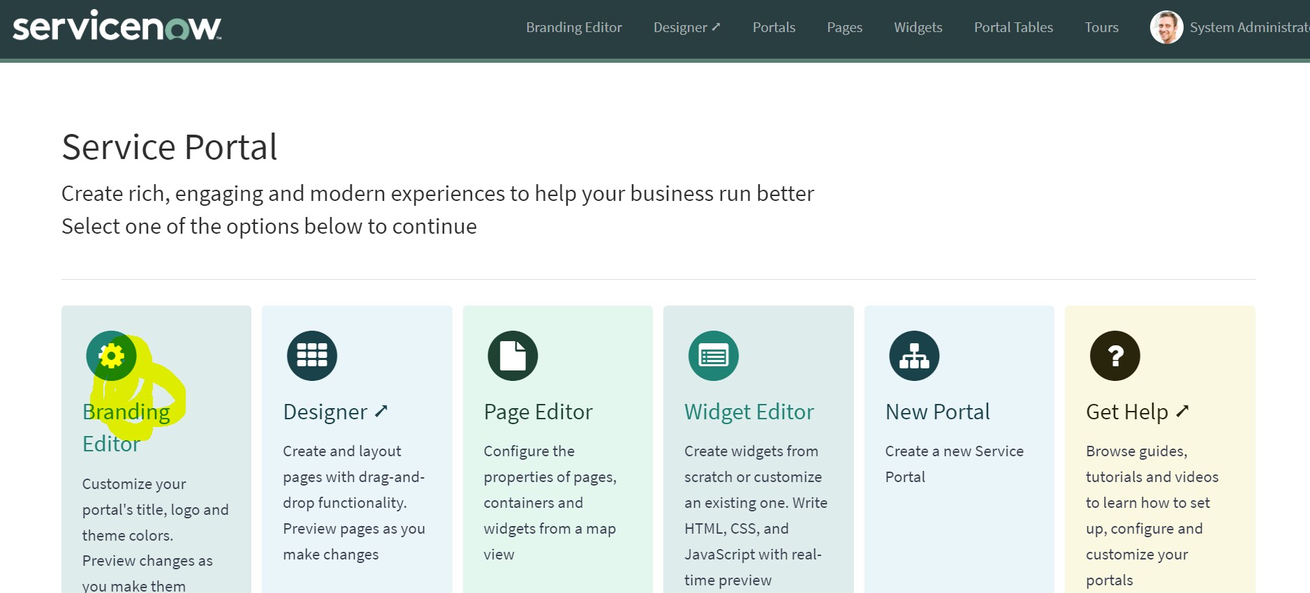

‎07-13-2022 04:33 AM
Hello
Hope you are doing good.
Please follow below steps to do it in east way
1) Navigate to service portal configuration
2) Once clicking on the above highlighted module click on branding editor
3) After clicking on branding editor please select employee center in the drop down like below and go to theme colors and there you can find first two attributes Navbar background and Navbar divider. Use this to change color codes (dark and light) which will be applied to your portal directly
Please mark my answer correct if it helps you
