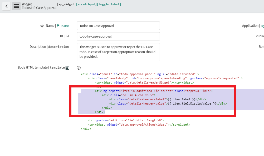

See below image. What I'm after, adding for example also the Description field to this section.
I did find already, that the section is made up in another widget, "Todos HR Case Approval". Haven't found yet where the "additionalFieldsList" is coming from. I would guess, that that would contain (out-of-the-box) only Short description.
I will do some more searching. Though perhaps anyone has already ideas or came across this 🙂

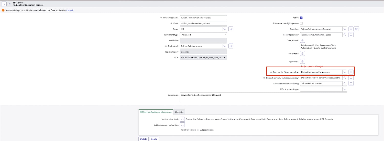

You are in luck that all you have to do is head over to the HR Service Based Case Configurations (sn_hr_core_config_case.list) or HR Case Header Configuration menu, and update the Default for opened for/approver record for HR Case and include Detail columns you'd like.

Thanks Loudigi for the detailed response.
I just wanted to add, that in case you have a need to show different info depending on the HR Case type, for example for a "Tuition Reimbursement Request" show data related to the courses vs for a "401(k) Retirement Plan Enrollment Inquiry" more specific data related to the inquiry, you can always create specific configs under "HR Case Header Configuration" for the ones you want to be more specific, and associate those configs to the specific HR Services in "HR Service Configuration".
