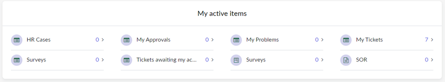

At the moment, I'm using the following out of the box widget 'My Active Items' on the employee centre portal:
However, there are certain options on this widget that we don't want to show as they are irrelevant on the employee centre portal. We're looking to remove the 'HR Cases' and 'SOR' options.
However though, what we've realised is that those two same options are also being displayed on our hrportal.
I was just wondering if there is a way that we can remove those widgets on our employee centre portal, but still keep them on our hrportal.

hi @matthew_hughes ,
Please goto Activity Configurations [sn_ex_sp_activity_configuration] then open HR case and SOR then you can see active field then click on that deactivated it

Hi @Bhavya11 ,
But would that remove it from all portals, or just the portal I need it removing from?
08-12-2024 02:52 AM
Hi @matthew_hughes ,
can you check widget if they used this "ActivityConfigurationUtil" script include or "sn_ex_sp_activity_configuration" table in server side script. for that you will get to know that.

Hi @Bhavya11 So the widget is using the ActivityConfigurationUtil script include.
