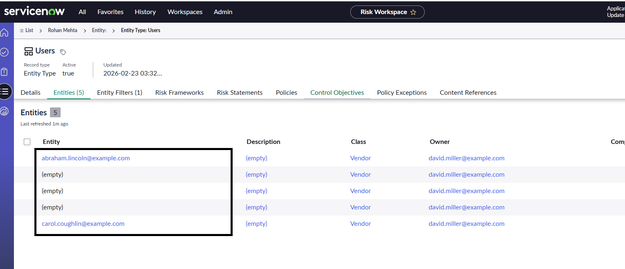

hi i am facing issue in entity type and entities i want name field as entity in my metric definition but by default it is taking email as entity field how to configure it

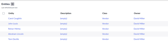

02-23-2026 03:47 AM
And now when I changed to false (email field),
Name are getting displayed :
02-23-2026 02:01 AM
look in your case entities are the names not the manages email id in all records like mine do u have any solution to it

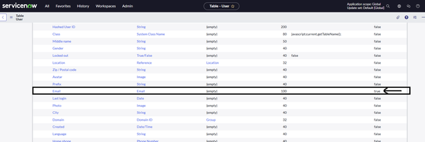

02-23-2026 03:43 AM
Hello @praharsh199 ,
I tried this in my pdi so there the issue is change the display value to true to the field you want to display in Entity Name :
So I changed the email field to true and filter out the records having manager as david miller :
So as a Result in Entities of entity types I am able to see email as entity name after generating the entity's :
So In short : Change the display value as True the field you want to display into entity name, and false the field if there is any..
02-23-2026 03:47 AM
02-23-2026 03:50 AM
As per mentioned by @yashkamde this is OOTB behaviour happens due to display value . Make display value =true for your required field and make email display value false it will work.
You can refer this : https://www.servicenow.com/community/developer-forum/entity-name-shows-quot-created-date-time-quot-r...
If this helps you then mark it as helpful and accept as solution.
Aditya
