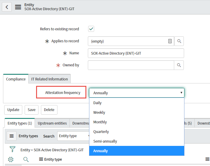

From my experience and understanding, the Attestation Frequency is set at the Entity level and not the frequency field in Control record; see pic below. So, if you open the entity that a control is belong to, you can see the attestation frequency set for all downstream controls in that entity.
From the behavior described, maybe the attestation frequency is set to 'Daily' in the control entity by mistake? Anyways, there's a daily job that check for the attestation frequency in the entity, then check the last time the downstream controls is attested to. If the frequency threshold is reached from last attestation, it will automatically move the control to 'Attest' stage.
The only way to prevent auto attestation (if you have manual attestation process in place) is to disable the nightly job (make sure to NOT remove it). The job is under 'System Definition>Scheduled Jobs' called, "Control attestation nightly run".

Thanks for the helpful advice so far. In my testing, when I set the control attestation frequency to something other than 'none', it does not regenerate, so I think the frequency is at the control level and not the entity. In addition, I looked at the scheduled job which calls the ControlAttestationUtilsBase script, and it looks like it will always set the control back to attest, it's just a matter of when. If no value is entered, it's immediate. I will wait for HI to reply and also ponder just putting in a condition in the script that won't reset the control state if no frequency is specified. I will certainly post back if I hear something otherwise.
