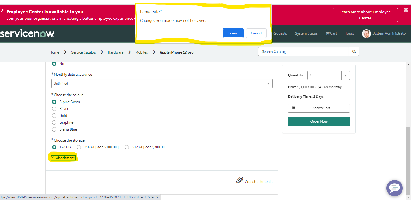

i.e. When I am trying to raise a sample test request and click on the Excel download link it hits a dialog box "leave/change" as shown in the below figure. When I click leave, the Attachment will be downloaded.
In the attached picture the "XL Attachment" is our customized variable for Excel download link. When I am clicking on that " XL Attachment " getting the highlighted dialogue box and after clicking on the "leave " in the dialogue box then  downloaded the attachment.
Can you please suggest me how to avoid that dialog box.

Hi @Hemanth M
Thank you for your prompt response!!
I have followed the above-mentioned steps as it is. The functionality is working as we expected except for one thing.
i.e. When I am trying to raise a sample test request and clicking on the Excel download link (XL Attachment) as shown in below picture, it is hitting a dialogue box "leave/cancel". After clicking on the leave button only it will be downloaded the attachment otherwise it won't download the attachment.
Could you please suggest me how to avoid that dialogue box.
Thanks in advance!
Manusha B
Hi @Hemanth M
In the 2nd picture add the bit HTML code to avoid the "Leave/Cancel" dialogue box.
Manusha B
