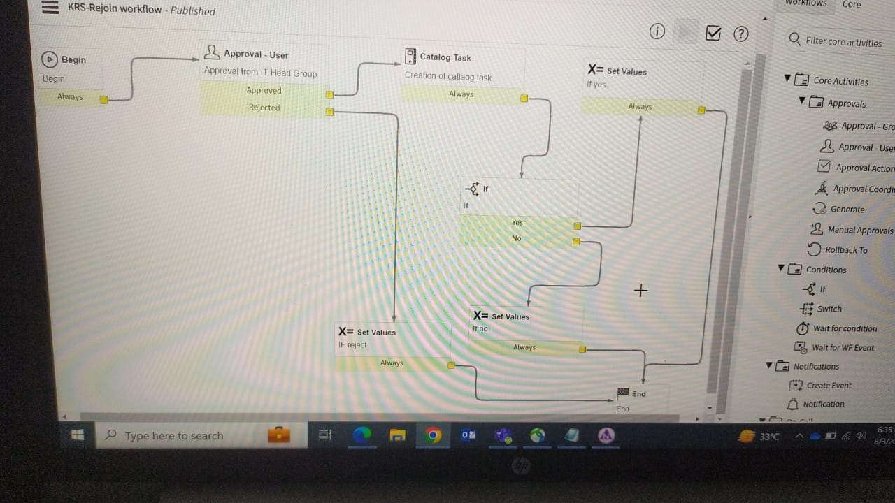

I have created workflow as per requirement if after creation of catalog task to fulfillment group Servicenow group up to here is fine.
After that I have kept the If condition Please help me how to kept the if condition for this requirement.
catalog task state value:
completed == 15
Cancelled == 77
  Requirement is if catalog task is
completed then request item(ritm)  is set value closed complete
if catalog task is
Cancelled the request item (ritm) is set value to closed incomplete
Please find the attachment for your reference to get clear idea about this.
main concern is how to write script for if condition for this requirement please help me regarding this.

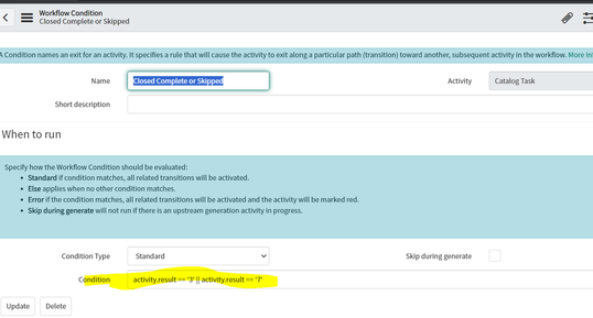

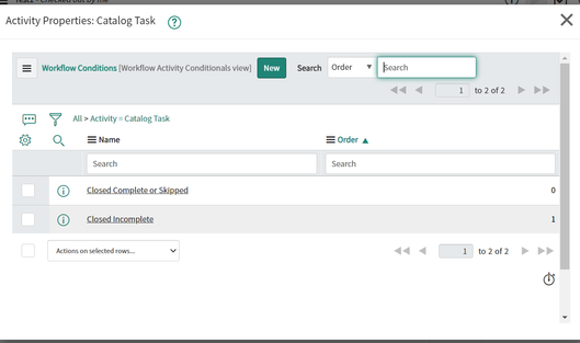

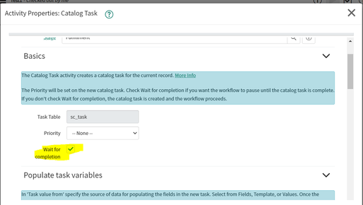

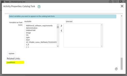

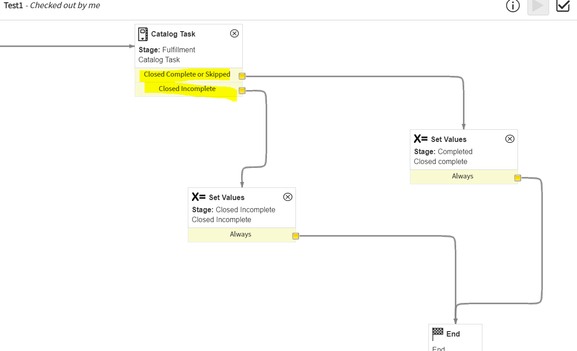

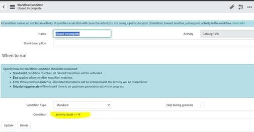

Vishal Birajdar
Hi @chandra sekhar8
You can just add condition in catalog task activity itself to check the state value shown as below.
Step 1 : In catalog task activity , Select "wait for completion" checkbox
Step 2 : Scroll down in catalog task activity and in Related links select 'Condition'
Step 3 : Remove the always condition and add below conditions
The state value taken in my case are OOTB , You can check if this works for your custom values.
or else you need to explicitly write a code to make RITM closed incomplete or complete.
Vishal B
