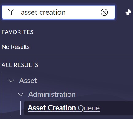

In that case, check Asset>Administration>Asset Creation Queue (indicated in attached screenshot)
