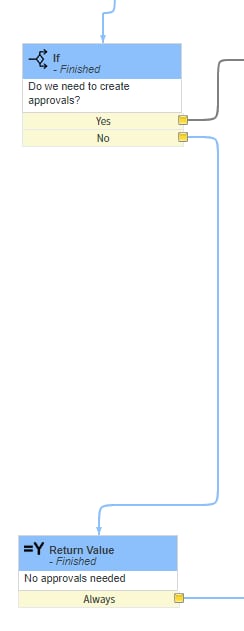

Per ServiceNow, the workflow that checks for approvals was skipping over the evaluation.
In the HR Service Activities workflow under "Is there an approval step" stage, the second if statement was missing some additional conditions:
While the version I had only contained:
if (serviceTemplates.next()}
return 'yes';
It should have been:
		if (serviceTemplates.next()) {
			workflow.scratchpad.serviceActivity = serviceTemplates.getUniqueValue();
			return 'yes';
I don't believe this was modified by anyone and may have been a bug but this is what ServiceNow had modified to make it work.
