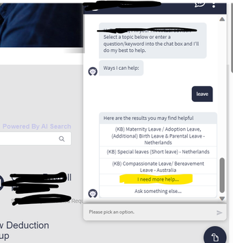

Hi experts, how can we remove this 'I need more help' option from VA aisearch.
Thanks in advance.

Hi @Community Alums ,
Greeting!
Please go to topic >AI Search
Follow the screenshot.
Remove the option "I need more help.."
I hope this helps!

Hi @Community Alums , not the topic but need to remove that option from the Topic.
