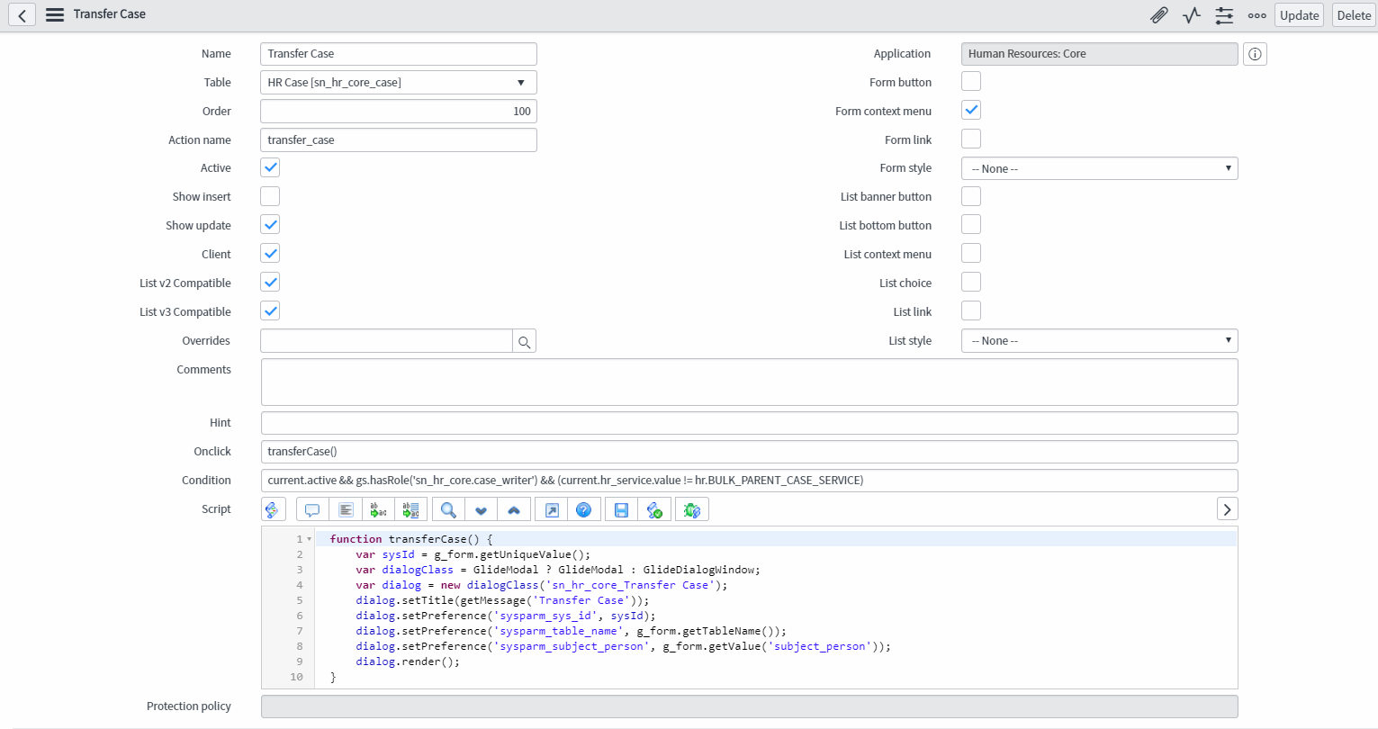

We have a UI Action called 'Transfer Case' which is OOB. When a Case comes in via email from the End User, it is created under General Inquiry Case (which is fine). When one of our team-members goes through those Cases to direct them to the correct Assignment Group needed, they can use the Transfer Case feature. When they do, the only option for the General Case is to be Cancelled. We do not want that as it will mess up reporting. Is there a way to still use Transfer Case, however leave the General Case as is, and let the Case worker handle what happens to it?

Any ideas, please let me know. Attached is how the Transfer Case UI Action is currently.

The behavior you are seeing with the Transfer Case is expected with the new scoped framework.  The original cases are closed as opposed to just reclassifying due to potential impacts to security when switching tables, pending workflows on the original case, new templates to be applied, etc.  While you could modify this UI Action, it is not recommended.
We added the Transferred To field in Kingston that you could use to identify and filter out transferred cases and that should help alleviate  the concerns around reporting.  We are considering additional modifications to improve this functionality in future releases as well.  I'm interested in hearing if you have additional concerns outside of reporting so we can consider that that feedback for future enhancements.
