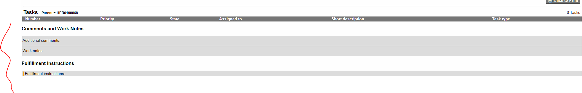

Rob Sestito
First, Thanks everyone providing options/suggestions with things. I reached out to SN directly because when I would try to use the system Print Friendly Version
Even that would cut off the additional tabs of information from our HR Case forms.
From ServiceNow:
It is part of PRB1153520 has been opened with our development team to correct the issue. The problem has been corrected in our upcoming Madrid release and we are currently targeting Kingston Patch 12 for the back-port.
Our instances are on Patch 9 for Kingston - so we will look to see if they can get this to Patch 12 and have it corrected. The workaround however, from the Tabs we have - I have to take Fulfillment Instructions and move it to the end of the list like so:
Originally, this tab was the first one, and we moved it to be the second one. But, workaround in order to be able to print everything is to move it to the end. Now everything shows up using the system print friendly function:
Again, Thanks everyone that helped with this. The system printing function will be just fine for us.
~Rob
