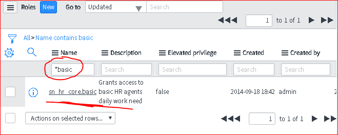

Once you click on Roles, you will be brought to the list of roles within your instance. From the list, you can do a search on the role you want to check on:
