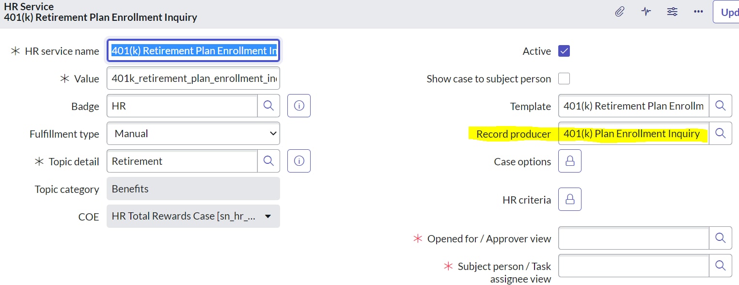

Navigate to HR Administration > HR Services > HR Service Configuration. Click New or open a record. Note: If you are creating a new HR service and plan to make it available for employee self-service, see HR catalog item configuration instead
Please see the detail in this ServiceNow document:Configure an HR service | ServiceNow Docs
